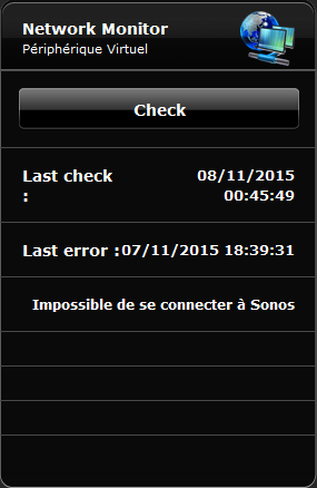

Network Monitor
Version 1.20
Voici un module virtuel permettant de surveiller plusieurs équipements sur le réseau local (et aussi sur Internet), et d'envoyer des notifications en cas de problème détecté.

Après import du module virtuel, modifier la section "User Variables" du 1er bouton du module virtuel :
-- User variables
local userID = {5}                 -- Mail
local smartphoneID = {73, 127}     -- Push
local sms = {
	["VD_ID"]     = 98,        -- Virtual Device ID
	["VD_Button"] = "1",       -- Virtual Device Button
	["VG_Name"]   = "SMS"      -- Global Variable Name
local icons = {
	["OK"] = 1028,                 -- Normal Icon ID
	["Error"] = 1045               -- Error Icon ID
local DEVICES = {
  -- ["Service Name"]                     = { IP Address   ,  Port, Protocol, Data to send, Expected return code, Expected data, Retry, {Notification methods}, VG, VG },
  ["Eco-Devices"]                    = {"192.168.1.1",    80, "http", "/index1.htm",       200, "Eco Devices"            ,     1, {"push", "email", "sms"}, nil, nil},
  ["HP ProLiant Remote Access Card"] = {"192.168.1.2",    80, "http", "/login.html",       200, "Remote Access Card"     ,     1, {        "email"       }, nil, {"Vacances", "1"}},
  ["HP ProLiant Gen8 ILO"]           = {"192.168.1.3",   443, "tcp",  "",                  nil, ""                       ,     1, {        "email"       }, nil, nil},
  ["ESXi"]                           = {"192.168.1.4",    80, "http", "/",                 301, ""                       ,     1, {"push", "email", "sms"}, nil, nil},
  ["Synology DiskStation"]           = {"192.168.1.5",  5000, "http", "/webman/index.cgi", 200, "DiskStation"            ,     1, {"push", "email", "sms"}, nil, nil},
  ["Raspberry PI"]                   = {"192.168.1.6",    80, "http", "/",                 200, "Welcome to nginx"       ,     1, {"push", "email", "sms"}, nil, nil},
  ["Sonos"]                          = {"192.168.1.7",  1400, "http", "/status",           200, "Options"                ,     1, {"push", "email"       }, nil, {"Vacances", "1"}},
  ["SMS Gateway"]                    = {"192.168.1.8",  9090, "http", "/",                 200, "Welcome to SMS Gateway" ,     5, {"push", "email"       }, nil, nil},
  ["VRT-IP"]                         = {"192.168.1.9",    80, "http", "/",                 200, "Volets Roulant de Toit" ,     1, {"push", "email"       }, nil, nil},
  ["IPX800"]                         = {"192.168.1.10",   80, "http", "/user/index2.htm",  200, "IPX800"                 ,     1, {"push", "email"       }, nil, nil},
  ["Foscam"]                         = {"192.168.1.11",   88, "http", "/",                 200, "IPCam Client"           ,     1, {"push", "email", "sms"}, nil, {"Vacances", "0"}},
  ["Hikvision"]                      = {"192.168.1.12",   80, "http", "/doc/page/login.asp", 200, "login"                ,     1, {"push", "email", "sms"}, nil, nil},
  ["HAproxy"]                        = {"192.168.1.13",   80, "http", "/",                 503, ""                       ,     1, {"push", "email", "sms"}, nil, nil},
  ["FHEM"]                           = {"192.168.1.14", 8083, "http", "/fhem",             200, "EnOcean"                ,     1, {"push", "email", "sms"}, nil, nil},
  ["Freebox"]                        = {"192.168.1.15",   80, "http", "/login.php",        200, "Freebox OS"             ,     1, {                 "sms"}, nil, nil},
  ["OpenVPN"]                        = {"192.168.1.16",  443, "tcp",  "",                  nil, ""                       ,     1, {        "email", "sms"}, nil, nil},
  ["Redhat"]                         = {"192.168.1.17",   22, "tcp",  nil,                 nil, "OpenSSH"                ,     1, {        "email"       }, nil, nil},
  ["Google"]                         = {"www.google.fr",  80, "http", "/",                 200, "Recherche Google"       ,     1, {                 "sms"}, nil, nil}}
local debug = false
  • userID : liste séparée par des virgules des ID des utilisateurs qui doivent recevoir des notification par email (le mail est celui configuré pour chaque utilisateur dans le panneau de contrôle d'accès)
  • smartphoneID : liste séparée par des virgules des ID des smartphones qui doivent recevoir des notifications push (à  récupérer dans le toolkit de Krikroff ou via l'API : /api/iosDevices)
  • sms : si vous avez une passerelle SMS sous Android avec SMS Gateway (ou équivalent) pilotée par un module virtuel, il faut renseigner ici les informations nécessaires.
  • icons : si vous avez 2 icônes personnalisées, remplacer les valeurs nil par les ID numériques de vos icones (à  trouver dans /api/icons)
  • DEVICES : c'est la partie la plus longue à  paramétrer, pour cela je vous ai laissé un exemple de tout ce que je monitore chez moi (j'ai juste changé les IP). C'est assez parlant, vous pouvez copier/coller en respectant bien la syntaxe. A noter que si l'avant-dernière colonne qui contient le nom facultatif d'une variable globale à  incrémenter, celle-ci est automatiquement créée par le module. La dernière colonne permet d'annuler le monitoring d'un équipement particulier en fonction de la valeur d'une variable globale.
  • debug : true ou false afin d'activer l'affichage étendu dans la fenêtre de débugage du bouton du module virtuel.
Dans la Main Loop, le code est de Steven. Il y a une variable nbHeure permettant de paramétrer l'intervalle de vérification, par défaut à  1 heure.
Si vous voulez un rafraichissement inférieur à  40 minutes, il suffit de tout remplacer par un simple fibaro:sleep(), car cette fonction ne plante pas pour les durées inférieures.

Ma vision des choses :
  • ce module ne remplace par le VD Check Internet, car :
    • il n'est pas capable d'agréger plusieurs sites web pour prendre une décision (Google n'est pas suffisant, il peut être indisponible, tandis que la connexion internet fonctionne encore)
    • La durée d'interrogation est fixe pour tous les devices surveillés. Surveiller une connexion ADSL toutes les minutes a du sens, tandis que surveiller un Sonos toutes les minutes est contre-productif (charge réseau....)
  • Au sujet des variables globale :
    • je ne suis pas pour créer un tableau, car comme dis Jojo, c'est impossible à  exploiter dans GEA, ce qui représente quand même la majorité des usages, n'en déplaise à  ses détracteurs.
    • l'idéal est une variable globale par élément à  surveiller, de façon optionnelles. Donc dans le tableau DEVICES, il suffit d'ajouter une colonne qui contient nil ou le nom de la variable globale à  mettre à  jour. Ainsi on peut surveiller les éléments critiques, et ignorer les autres. C'est relativement facile à  implémenter.
  • Idéalement, dans le futur, il faudrait ajouter un intervalle variable pour chaque device à  surveiller, mais cela oblige à  revoir la structure de tout le code, donc ce n'est pas à  l'ordre du jour.

Bon, je vais m'attaquer àla mise àjour de ce module virtuel.
Pour les variables globales, ça sera donc une variable globale par équipement réseau surveillé. Un nouveau champs dans le tableau DEVICES permettra de configurer le nom de chaque variable globale.
Quelles valeurs vous plairait ?
Je pense faire très simple :
  • 0 ou 1
  • "OK" ou "Error" (ou NOK, ou KO)
Perso je préfère les numériques,il suffit d'un tonumber() dans d'autres scripts pour les utiliser.
0 = OK
Puis 1 2 3 4 etc suivant le nombre d'erreurs ?
